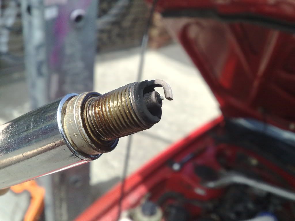

    Here's my whitish spark plug...Am I reading the plug ok? Looking at internet plug pics is making me uncertain......Found this good site by the way: http://www.usaimports.co.uk/Mopar_Te...ug_Reading.htm
