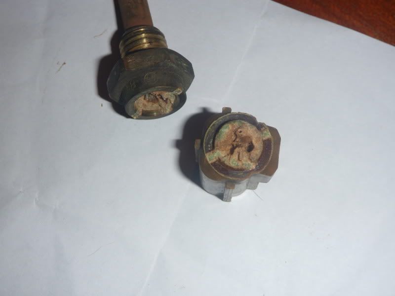

    Ok, I finally got around to changing the ECU coolant temp sensor today.
    When i went to take the old one out, it was already disintegrated. It came out in 2 pieces.
    Anyway, I put in the new one, put it all back together, and now I am very happy.
    It is amazing the difference it makes in performance, much more responsive and I got heaps of power back. And after a drive, it used about HALF (seriously) as much fuel as it would have before for the same distance.
    thanks guys for steering me in the right direction

    Quote Originally Posted by JoJo View Post
    A++, Good job.
    I assume that the engine was always running rich (even when hot) because of a bad coolant sensor?

    yeah, that was the case. Because the sensor was so brittle, I think it was already broken before I touched it. So, it wasn't actually working at all, fooling the computer into thinking it was always cold (ie; more fuel).
    I don't know why Toyota didn't incorperate this into the diagnostic system. For one sensor to have such a huge impact on performance and fuel economy, you'd think they would have...

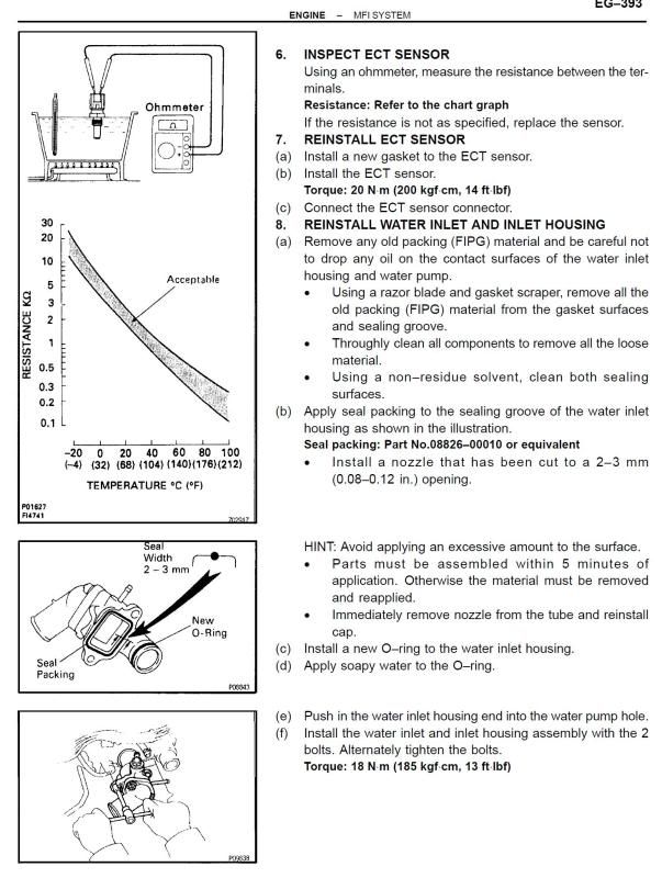

    I should test mine, what voltages should I get when cold and fully warm?
    Same for all toyotas?
  14. #59
    801
    Default Re: Celsior seems to be using more fuel suddenly.....
    Is this what your after?
  15. #60
    Junior Member Carport Converter Z2TT's Avatar
    Nov 2007
    1,612
    Thanks, so I assume 90c Should be what it is when it's warm. So should be about 0.2 to 0.3 Kiloohms.
