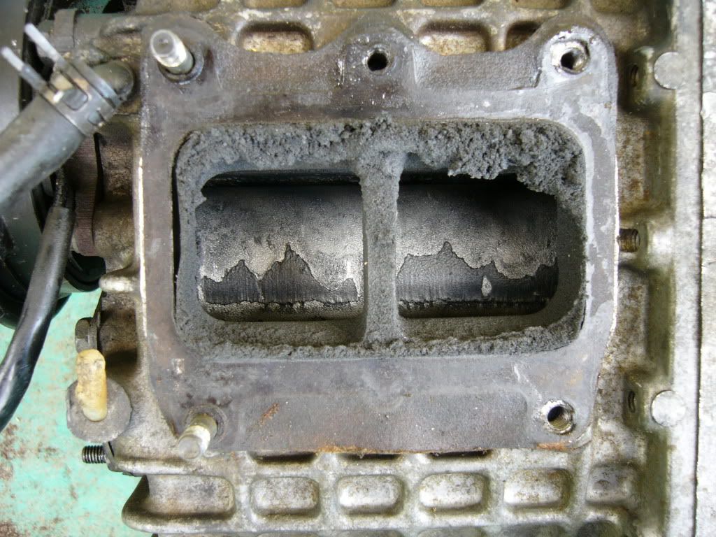

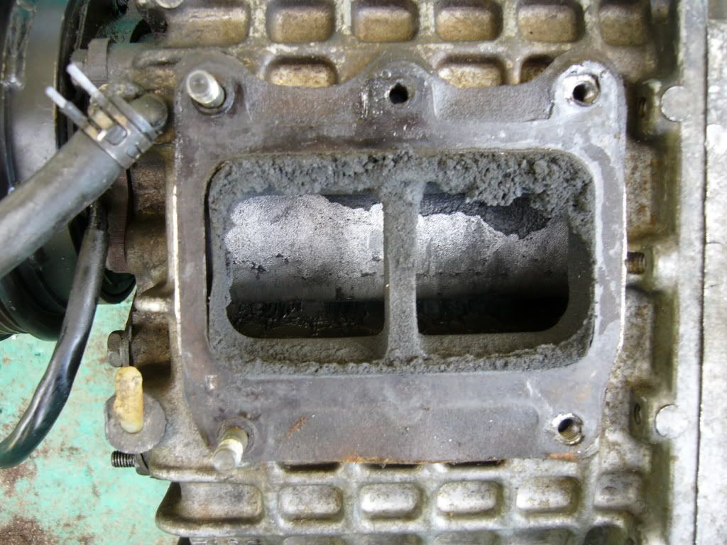

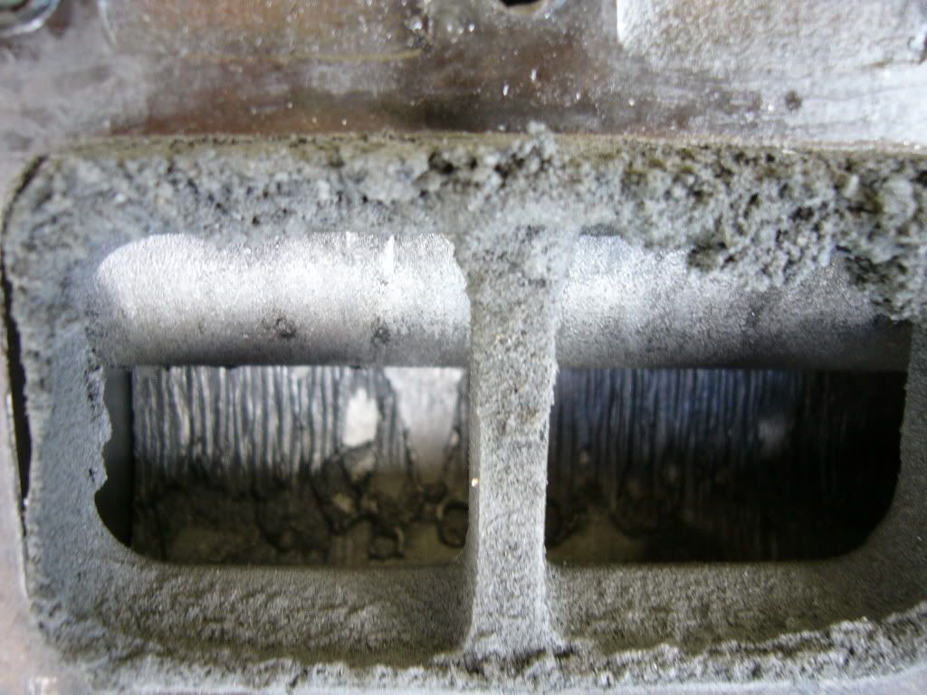

    SC14 chargers pump more air per revolution, which basically equals more boost for less heat rise.
    The temp problem isn't the charge air after the charger, it's the temp inside the charger itself as the air is compressed into the intake piping. There's no way to regulate that apart from lowering boost, or fitting a bigger charger.
    The problem is in the Teflon coating melting at high RPM or boost.
    This is the result of over temp:

    That is pretty fcuked hard, how likely is that to happen?
    Wouldn't that only be if it was at a sustained boost level for a long period of time?
    So in the long run its been to go the sc14 with the 175mm pulley? But for the short term it should be fine with the sc12 if its maintained properly?

    SC12 should be ok if you keep the boost to shorter bursts, so the charger doesn't overheat. That one above is well stuffed, from standard boost but a bare pod in the engine bay sucking hot air. Hot = bad for SC chargers....
    Cold air induction is an absolute must in any application.
