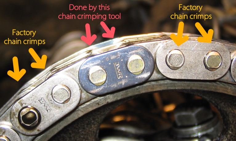

    I will need a special tool to unlink and re-link the chains...
    do I...?
    2,144
    Default Re: 18r / 18rc timing chain kits differences
    No. There should be a shiny link in your old one that is the one to un-do.

    ahhh... found one...
    there is a tool then.... called chain crimping tool...
    now I know how to link it back...
    Problem is how to undo the link...
    Update: This is Great
    http://www.dieselgiant.com/replacetimingchain.htm
