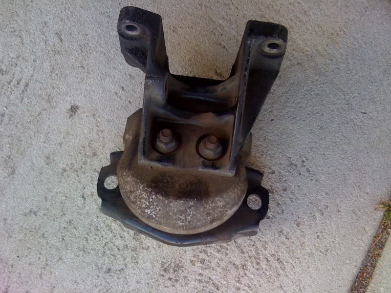

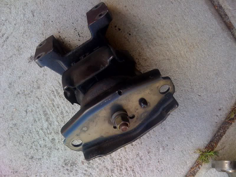

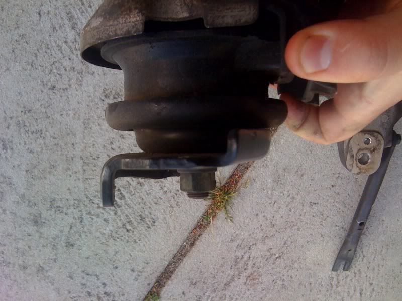

    ok.. i actually know which car this is from.. but the person who we bought the motor from kept one of the engine mounts.. fuck knows why.. but they did..
    so, please look at the pics and tell me what this engine mount is from..
    the reason i cant just call toyota or wreckers and order one given i already know what its from is coz what its from is fucking rare...
    the reason im not saying its from a xxxxxxx. is for 2 reasons.. 1 i dont want to confuse people.. and 2 i dont want 30 people jumping on and telling me.. "yup.. its definitely from a xxxxx"
    anyway here are the pics.. of the mount and crossmember it will sit on..
    drivers side mount (top view)
    bottom view
    side on view
    engine bracket bit of engine mount we need (note there is only one bolt hole, not 2 like the drivers side..)
    cheers in advance.. i need help quick..this conversion needs to be finished fast..

    They look to be the same as my GX81 mounts and rubbers. I take it these are the mounts from coFF33's 1G-GTE?
    The bottom part and heat shield bit is the same as any X8 mount, so you should be able to pinch them from a MX83 pretty easily.
    Since the MX83 rubbers arent the toughest of things, there is a mod that cseufert on the Cressida forums has come up with.
    He upgraded them to JZA80 Supra mounts which will suit your 1 bolt bottom and 1 bolt top configuration you are chasing.

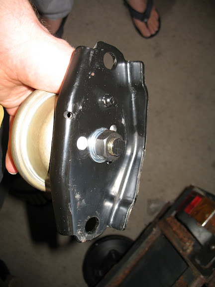

    The Supra mount and X8 lower plate
    You need to open up the main hole to suit and also drill a locating hole since they dont match, and also trim down the main bolt.
    You need to trim the rubber agains the lip so it sits flush
