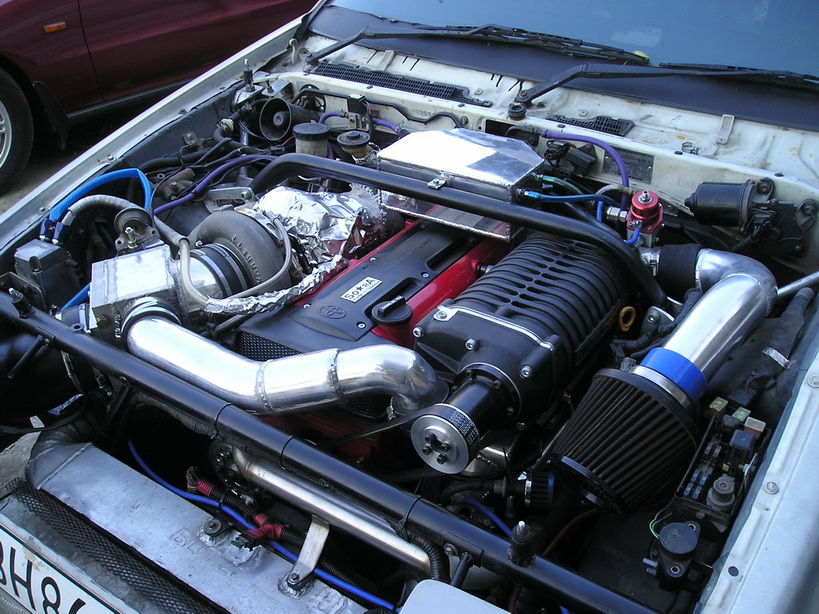

    While i never thought this was a good idea, i did stumble across this
    And check out the exhaust manifold!
    Here are the threads, although I havent had a good look through them so i dont know how much info is in them and the owner is from the Ukraine so his english isnt the best:
    http://www.aeu86.org/viewtopic/ae86/...er=asc/start=0
    http://www.hachiroku.com.au/blog/?p=270
