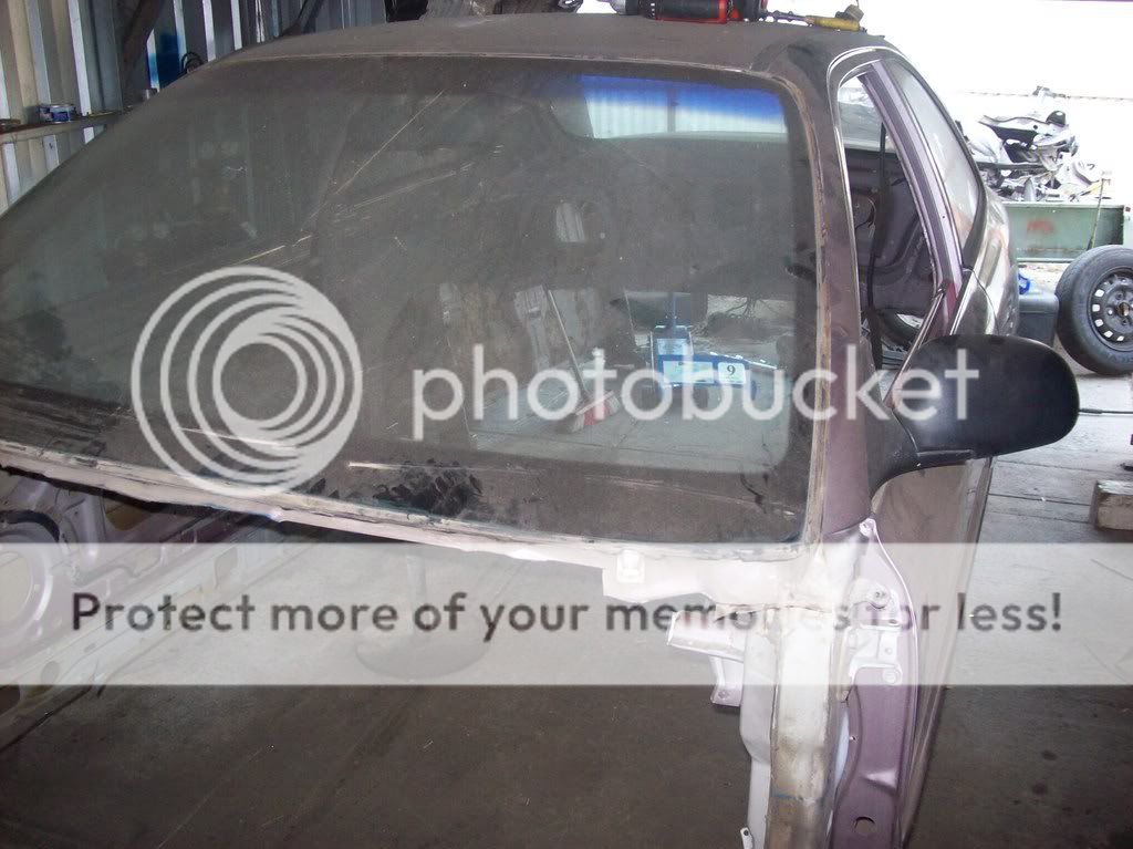

    We did this just for an IRS conversion -
    Not to mention cutting the firewall out and replacing with another one that was set back and larger. Probably a similar level of work to the 4WD version but I didn't care about track width or running massive flares, legality is also a lot easier in NZ than Oz and I had an ex panelbeater doing all the work.
