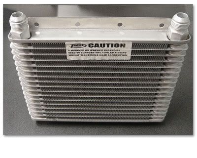

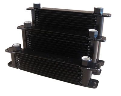

    here are the PWR cores i was talking about:
    both of these examples are bar/plate, the black one is "close mesh" the silver one is "high fin", ive got absolutely no idea as to which one is more efficient or suitable...

    PWR have a good reputation. Again talk with them about sizing.
