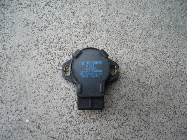

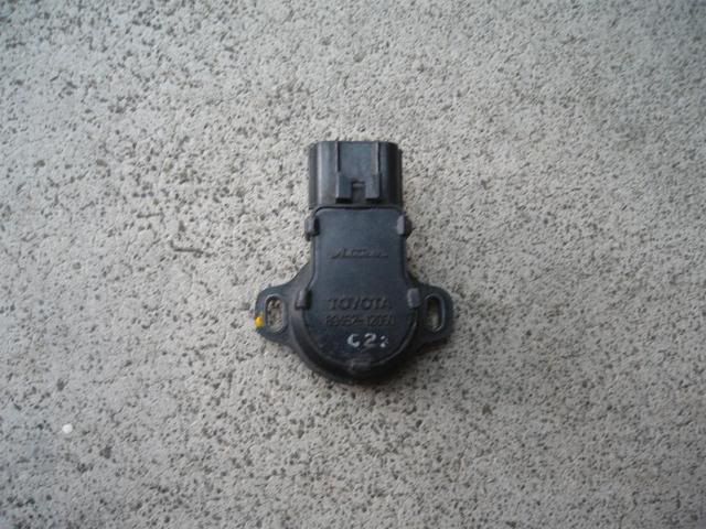

    Default Re: Idleing at 4k - 4age help??
    big port
    small port
    small port tps I have got, according to the picture above
