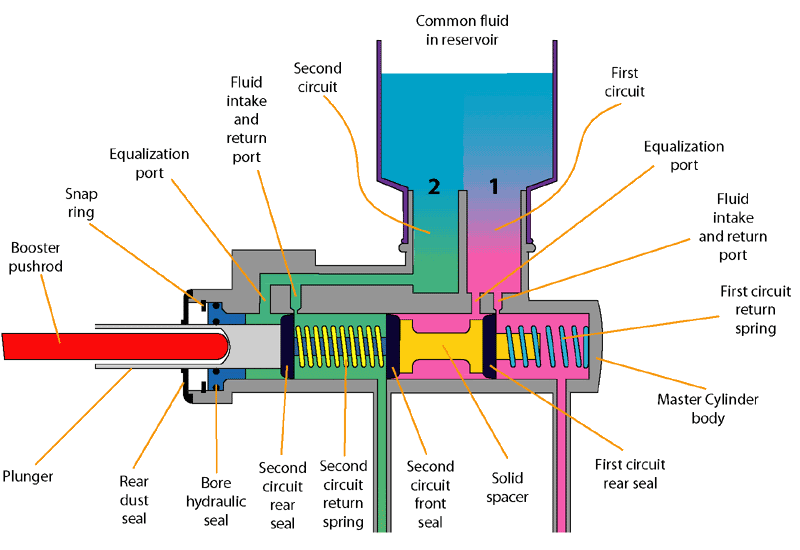

    [IMG][/IMG]
    have you fitted your piston the wrong way perhaps?
    springs in the right place? seals not back to front?
    return spring in place and is the piston actually returning?
    or maybe the second circuit has a leak thus not enough hydraulic pressure to push the first circuit to allow fluid pressure for the rear brakes.
    this is a built in safety requirement for all masters.
    pull master away from booster. should be wet if its leaking (around rear dust seal)

    Quote Originally Posted by frostyadonis
    I put everything back the way it was in the correct order and the seals the same way around. Yeah the piston comes back if I push it in. It was leaking, I took it apart, replaced the seals and now this shit. Its not the first time I've refreshed a master cylinder. I've done it several times and never had a problem.
    also when your bench bleeding is fluid squirting out of the rear brake line port as well as the front?
    Plenty coming out the front nothing to the rear.

    Default Re: MX83 brake master - WTF?!
    masters can be bench bled by blocking the ports off
    so no air is drawn in when the piston returns
    some places use threaded plastic blockoff plugs
    or spare crimped pipes with the nuts tightened
    the air escapes through the reservoir
    just keep bleeding untill all the air is gone
    be gentle with it or you'll get squirted in the eyeballs
