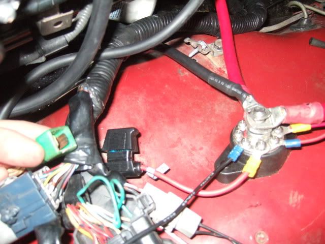

    BUT, the ignition fusible link has just blown for the 2nd time, so might have a go at wiring it up as per cam's direction's and see how that goes.
    edit: heres a pic of how its running, the green plug im holding is what the fusible link plugs into, which is just connected to the distribution block.....the black wire is the alternator charge wire....

    Thanks for posting up pics of that distribution post. I'm going to add that to the Jaycar range now
