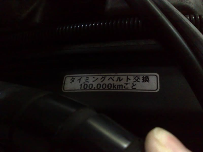

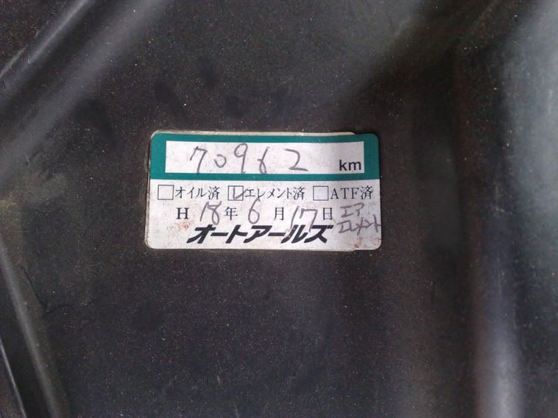

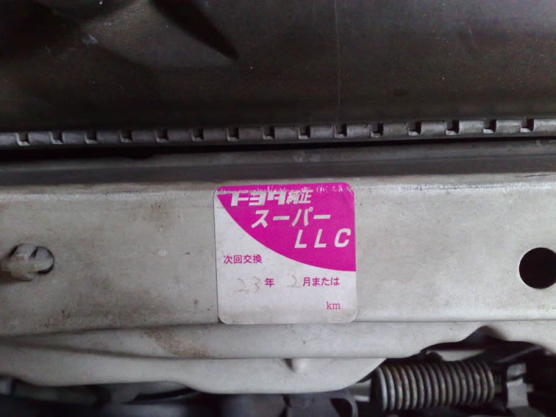

    these are the stickers that were on my car, checked the other belts and they look quite new, obviously a bit hard to tell as the top on the belt with the writing on it runs on a roller so the writing is worn off..
    inside the door on the side of the dash:
    on the rad support:
    on the air filter:
    on the timing belt cover (guessing oem reminder sticker):

    dunno bout the others (maybe someone who reads japanese), but the last one is jsut the reminder sticker.
    When I bought the timing belt for my last Dina, it came with a sticker to write on saying when it had been done.

    P/S? year Heisei 19(2007)-August, 115000km maybe that is the reminder for next change for oil... since you got the car before that km's.. or you got a wound back car.
    second one,
    oil and oil filter were done at 104000 (but you got the car at 103? weird..) the date part of the orange crap might get torn off when the change is done.
    lower two, engine flush? oil change? at 53Kkm...
    i hope it had oil between those times...
    purple one.
    toyota long life coolant. good until heisei 23(2011), feb.
    next, air filter changed at 70962km
    last is reminder sticker.
    looks like it may not have been serviced often, or rarely at toyota (who are really cheap here... heck i get free oil changes every 2000-3000km...)
