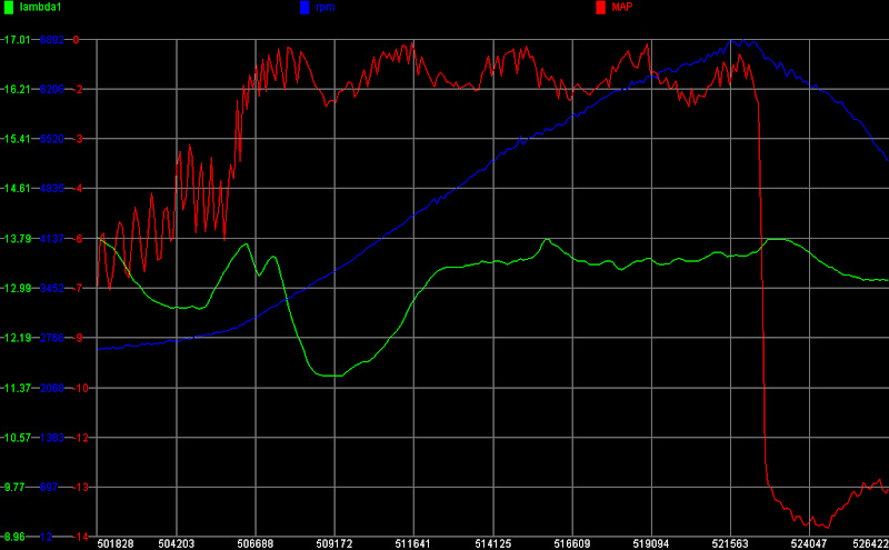

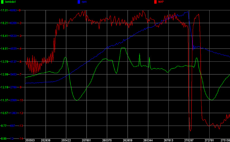

    Well an Update the problem is almost solved now. After much reading and playing around with jet and mapping the difference I've been able to achieve the following graphs. Note these are both the same jetting just in opposite directions along a long straight road near my place.
    The carby setup currently stands at 34mm chokes, Main Jet 135, Main Air (modified 200) approx 140 (54 drill), Pilot 60 Pump jet 45 and middle hole
    Opinions please on how to remove the dip at the start then she'll all be apples.
    Thanks
    Jason
    Last edited by Celica_73; 19-04-2009 at 07:42 PM. Reason: Still learning to upload Pic sorry!
    539
    Default Re: 3T/2TG Hybrid AFR Troubles
    Map them against the revs and the length of the intake tract and you may find each peak and dip are resonate frequencies. The last couple of Race Magazines have had some interesting articals on Intact design with some interesting tables and graphs of revs verses air flow/volume.
    The rich dip maybe at the transition from pilot to mains. Try the same run starting with lower throttle openings at 80k cruising and go WOT above 3500rpm to see what the graph looks like.
    When on the track if that is your aim your running mostly above 4000rpm and light throttle going to WOT exiting the corners.
    So has the off line hesitation and bogging disapeared? The most annoying issue on the street.
    Regards
    Rodger

    This car is a daily driven car (only car I have) and no play to put it on a track as long drive From Coffs Harbour to any track to start with. I tend to 'play' with setting on the weekend due that give enough time to revert what ever I've done so i can drive to work. The hesitation and bogging is still the but no where as bad as it use to be as that dip use to go off the scale!
    As reguard to the rich dip in the AFR/ lambda just to clarify those runs were first crusing but about 60km before WOT. So the test your suggesting is to criuse at about 3500 rpm around 80km/h then open up to WOT to see the results. If thats the case i did that test a while a go the dip does go but only when above 4500 rpm. I'll try it this weekend with current setup. Just going off how the car is currently driving I'd say it will be a simular result.
    Cheers for the input
    Jason
