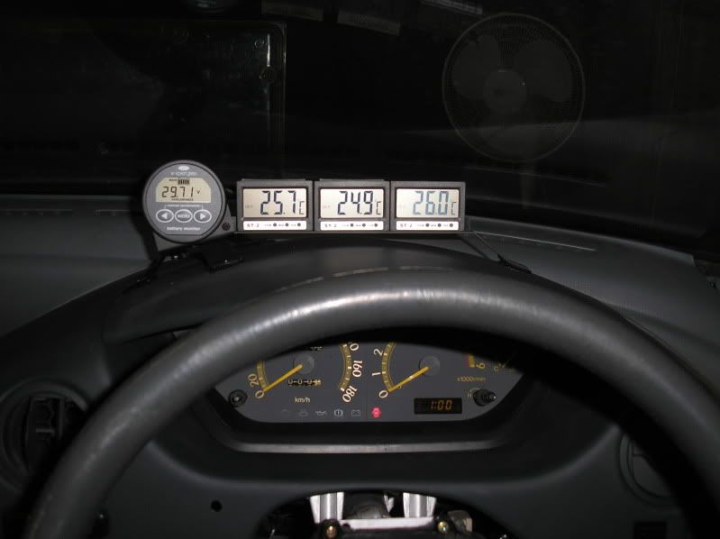

    Was hoping to take it for a test drive yesterday, but had a few wiring gremlins with the 12V stuff.
    Something was causing the ‘ignition’ line to latch on, so I was unable to turn off the system once it was started (not good for tests!)
    After a couple hours of screwing around chasing the fault I tracked it down to the EFI relay, removed it and all was well, no need for it anyway ;p
    I built a little (temporary) circuit to drive the check eng and batt waring lights, as the Zlla uses these to indicate error codes.
    The circuit also incorporates a throttle limiter relay, which shunts 2k across the TPS if a fault condition is detected by the battery monitor box, effectively limiting the power output to about 20% for a ‘limp home’ mode. There is also a buzzer that sounds if a fault is detected, fortunately it hasn’t gone off yet (fingers crossed).
    The additional temperature and battery monitor gauges are now installed on neat little Velcro mounted brackets on the dash hood, again somewhat temporary.
    Pics!
    Gauges
    Somewhat-completed wiring, & driver box thingy (lower left)
    Eventually the little driver circuit will also provide tacho signal processing & a warning output in case of the small cooling pump failure, but for now just the essentials.
    Test drive this afternoon for sure!!!
    Stay tuned.
    -A

  10. #310
    Chiba
    2,232
    Should hook the temp gauge in the dash to the water cooling for the zilla.
    Looking good so far!

    Jun 2008
    252
    Good point TERRA_Operative
    That it another thing for my to-do-list, course I have to mod the scale for the sender.
    As normal temp will be about 40C, over temp being greater then 70C.. shouldn’t be too difficult.
    Also would like to get the fuel gauge to indicate state of charge, (bit more difficult though).
    -A
