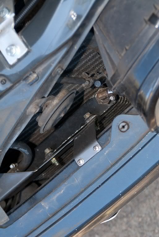

    Another small update
    Have now repaired the A/C, re-routed the cooling system & had some nifty decals made up.
    The speed controller cooler has now been placed in-front of the A/C condenser so it no longer gets all the hot air dumped into it, causing the controller to over-heat.

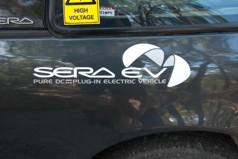

    Decals!
