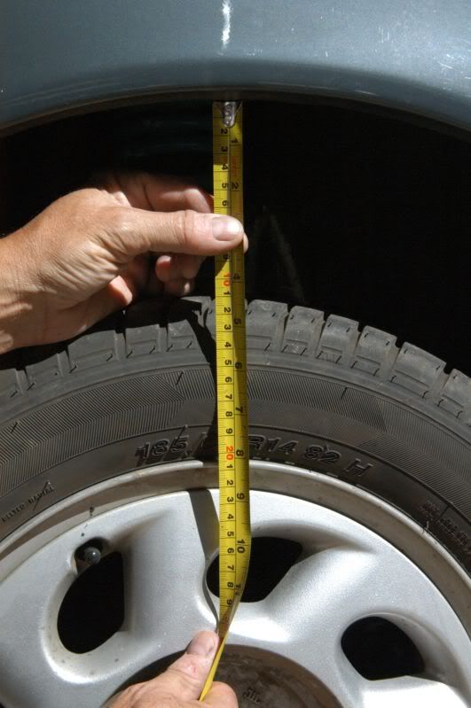

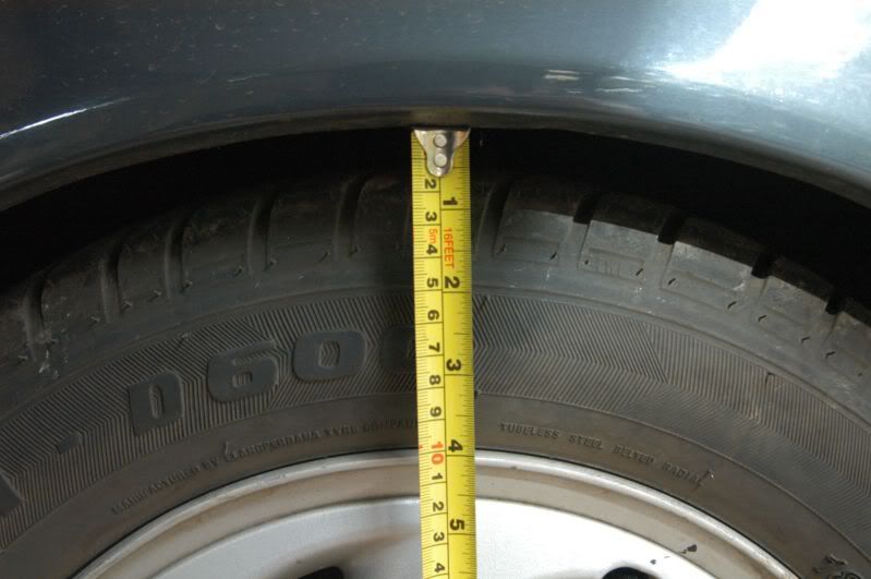

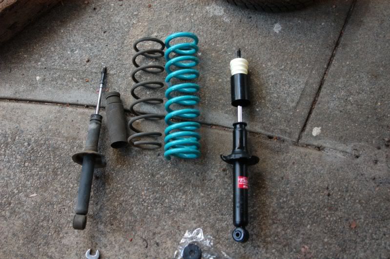

    New rear springs came in a few weeks ago, finally got round to installing them last week, decided to buy some new struts too, as the old ones were looking a little sad.
    Old v new:
    The springs are custom made aurora 5.5kg jobbies (starlet template), and yes they are crazy hard.
    Old ride height:
    New ride height:
    Yes it looks like there is a 2” lift kit installed, I may end up cutting a turn or 2 off the springs, just got to make sure they will remain captive.
    The handling has been significantly improved, no more hitting the bump stops every 5 seconds, corners flatter and does not roll around as much.
    A little bit expensive, but indeed necessary.
    -A

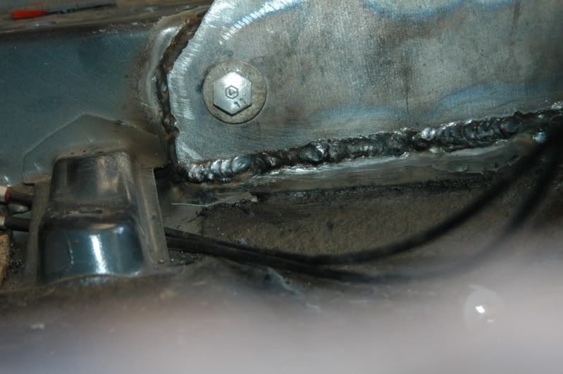

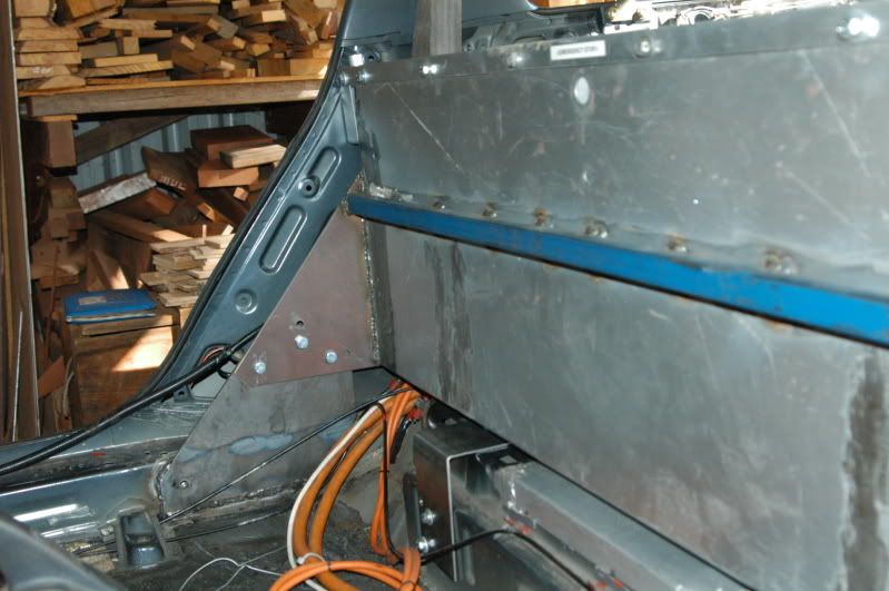

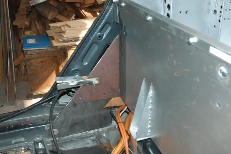

    Ok have now removed most of the interior again, box is out and in the process of having upgraded mounts & support bars attached.
    Progress thus far:
    Test fitment of main chassis brackets:
    Close up of welds to chassis rails, this was a little tricky to attach 8mm plate to 2mm pressed steel, in very awkward positions...
    New main support brackets bolted in position (note extra holes to reduce weight, totally intentional )
    Now need to cut, bend & weld in the beefed up secondary support brackets.
    The upper brackets will remain un-changed, if all goes well I should have most of it done by next week.
