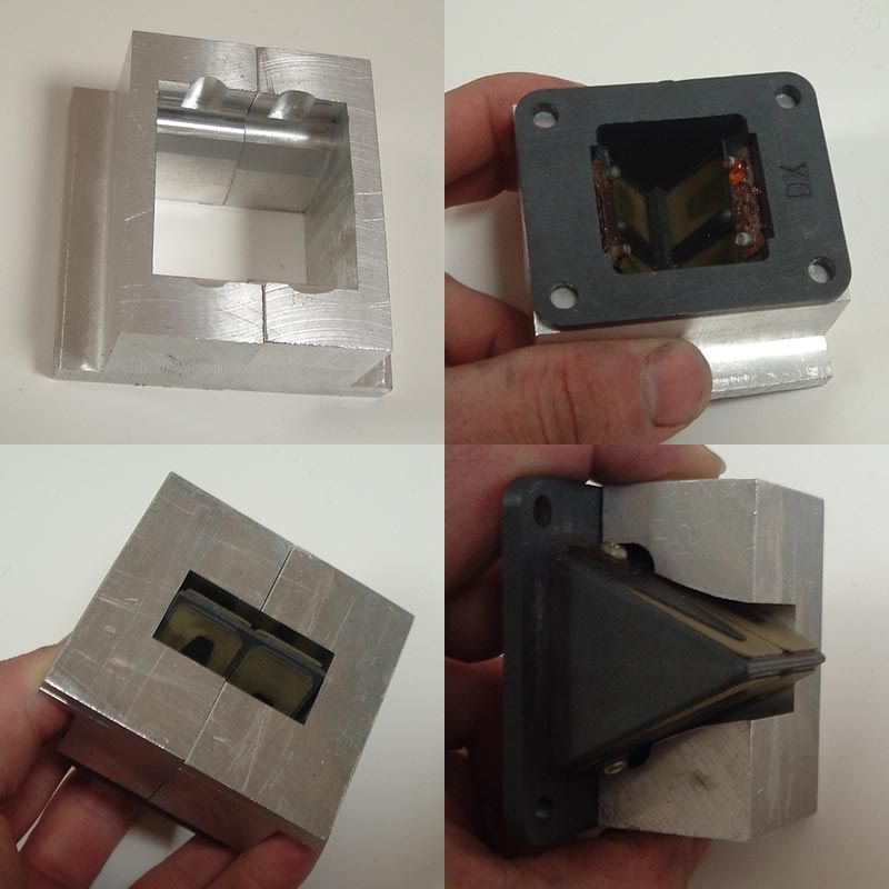

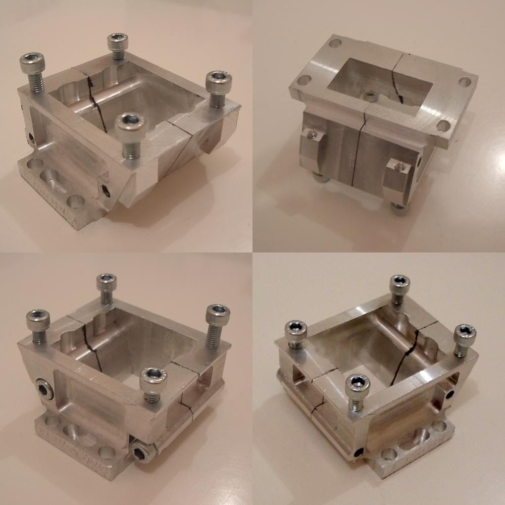

    Also I thought you guys might be interested in some pics of my progress so far:
    part 1 of the barell, more work has been done since
    the reed block housing part 1:
    Part 2:
