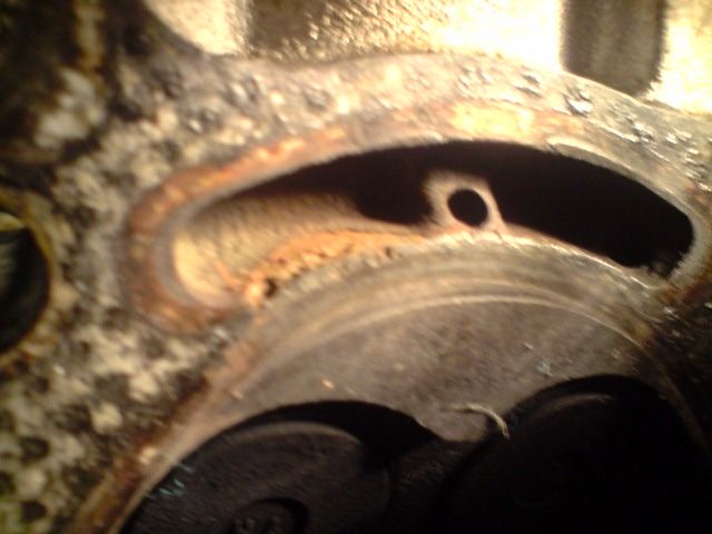

    I saw those pictures kristel, that head doesnt look healthy, will you be able to weld up those coolant jackets?

    This happened:
    (It's the same in all the water jackets)
    The head will now have to become a coffee table.
    EDIT - Kedderz - Don't think I really want to. Would much prefer to have something I know is 99.9% okay, rather than masking problems.
    Does anyone know what causes this????

    Its corrosion im afraid. Ive taken apart 3 7m's all of them had this to a certain extent, but none as bad as that.
    Welding it up isnt dodgy, drop it in to phillip head services or the like and ask them to see if its worth salvaging.
    Remember a second hand 7m head could be just as bad.

    I can't see the pics but from the description it sounds like a corrosion issue.

    Quote Originally Posted by Kristel
    Poor choice of coolant in the past.
    Toyota red is the only way to roll.
    My KE25 thread

    Default Re: Toyota Nationals - 10-13 April (Easter) 2009 = Canberra Cruise to Dubbo
    Yep, thought that would have been a contributing factor. *angry face*
