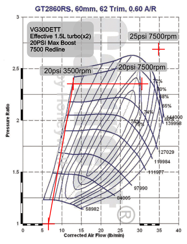

    Been following this thread for a while now.
    Some really useful info accumulating.
    Out of curiosity has anybody done the numbers for a moderate twin upgrade for a 2JZ?
    Since I am running a VG30 (don't hate me!) they should be fairly similar in air flow.
    I have been looking at getting a pair of faster spooling GT25 to 28's.
    I am aiming for about 400RWHP & after response over absolute power.
    I plugged in my numbers (for 1.5L) here:
    http://www.lovehorsepower.com/joomla...id=4&Itemid=88
    And came up with a plot here:
    From what I can gleam it looks like a fairly good match, but wont go much higher then 20psi before choking.
    Dose this look about right?
    I kind of figured a GT28 would be a little large for effectively 1.5L, so I am not sure if I ran the numbers correctly.
    An input would be much appreciated.

    VA61DETT:
    I would have thought that your 3L should be able to get that kind of power @ less flow. 400RWHP, should only take around 25lb/min per turbo (around 500 engine HP).
    Without being familiar with your engine, by my quick calcs, around 25lb/min per turbo, @ 18psi and 6500rpm should put you about where you need to be. I would not expect you to be able to make max power much higher than that unless your engine has some cams or something to help it breathe that well up to 7500rpm.
    Have you had a look around the Z forums, as I'm sure that this kind power level would be well documented for you to compare.

    -boxh34d
    Cheers for the info,
    I have been looking all over, but I have had a little luck on finding decent info.
    Hence posting here, since people seem to know what is what
