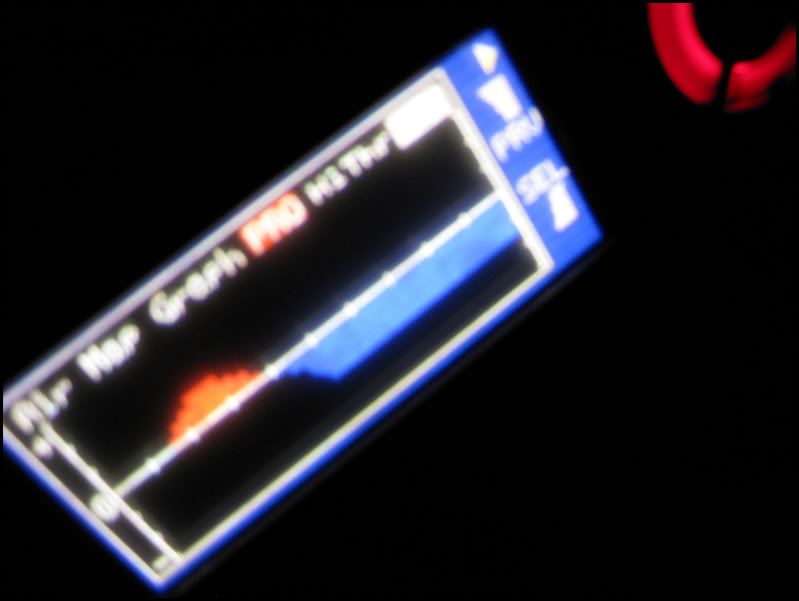

    1jz mx83 made 306 rwkw on 22psi with this tune i know its heaps coarse i have another map that i propose to use but i dont have time for the dyno anytime soon so ill post it up soon too... maybe someone can give me their opinion on it

    no offence but is there any point posting blurry or small images that no one can read any info off to help?
