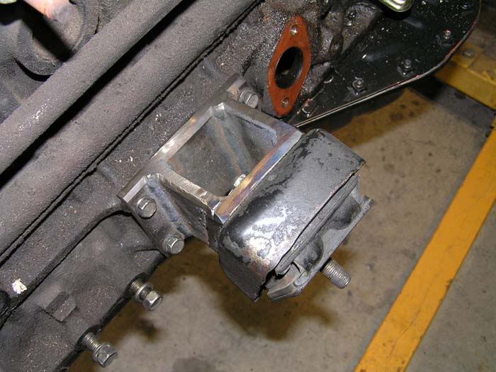

    Hi, just wanted some ideal on how to make the engine mounts to fit a 1GGTE into an RA28 with the TA23 cross member Installed.
    I am thinking the mounts are off the shelf with a custom adapter plate but haven't seen to much info in my searches .

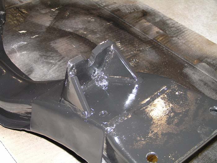

    This is how i had them in mine. Custom everything using the rubber mounts that were in the car before so im not really sure what they are from

    thanks guys, I have A TA23 xmember like screaminrollers setup the items for sale & the other links are for a RA23 xmember..
    When I picked up my engine I got steel mounts similar those on screamers engine so I just need to find out what the rubber mounts are from?
    The steel mounts I have are 10mm thick, do these need to be so think?, the factory ones are only 3-4mm thick.

    I have a feeling the rubber mounts are off the stock 1G steel mounts, not 100% sure though.
    10mm thick is heaps, thats what mine were done with.
