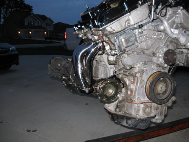

    Have you got another pic like this (ie end on), but a bit more side on to the motor? I'd like to see an end on pic showing where the shaft goes into the gearbox.
    It seems interesting that the bottom of the block looks quite upright, certainly compared to a 1MZ.
    May even be room for a 4wd transmission to fit up there without modification.
    a 4wd box definitely fits there. they have a few models in the US with that motor in a 4wd/awd configuration. the venza and the rav4 both have it.
    it uses the classic celica all-trac configuration.
