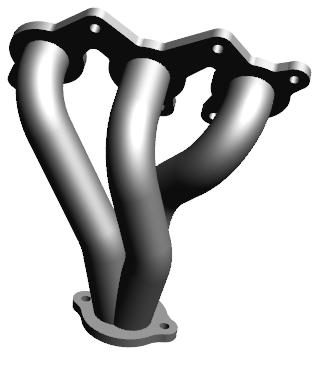

    just keeping you guys posted. i want to see if i can hit the 300WHP number with the stock ECU. I'm getting headers manufactured which are a much better design than my original one.
    These are 42mm equal length primaries with a 2.25" collector.
    The other advantage these have is they will be being made in a production run so i can actually sell some to other people that want this swap. the retail price on these will be lower than my material cost on the initial set that i made personally.

    oo... designed on CAD... i like...
    I can't see the merge collector so well, but it looks from that angle like your last bends form part of it... i can only imagine that being a nightmare to cut up. Also, personally i'd break each length of pipe up into it's components... i.e. 2 bends, and 3 straights... just for being pedantic if nothing else...

    Quote Originally Posted by RAd28
    Actually no, the collector is only in the strait sections. the merge angle is 12* with each pipe coming in 120* from each other.
    I'm not sure what you're asking about the components. all three pipes have two bends each with a 57.5mm radius. also, the last angle coming into the collector is all in the same tangent direction so the exhaust gases should not fight each other as much. but that's just a speculation.

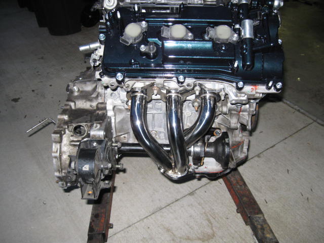

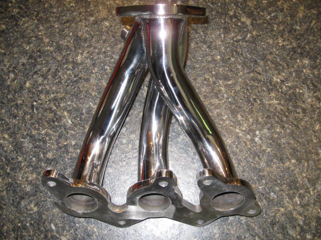

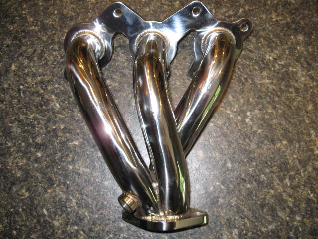

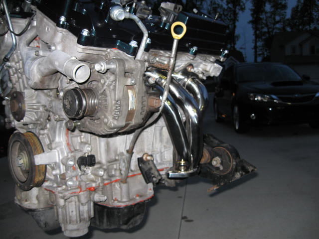

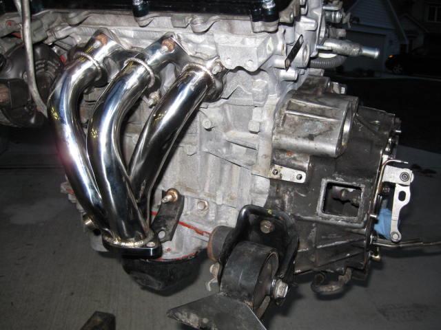

    Default Re: 2GR-FE in a MKII MR2!
    what updates would you like?
    the headers are nearing completion, i should be able to sell them here in a few weeks.
    here are some shots of the first units (not exactly like the final units will be, but close)
