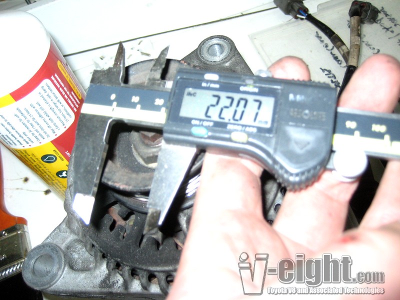

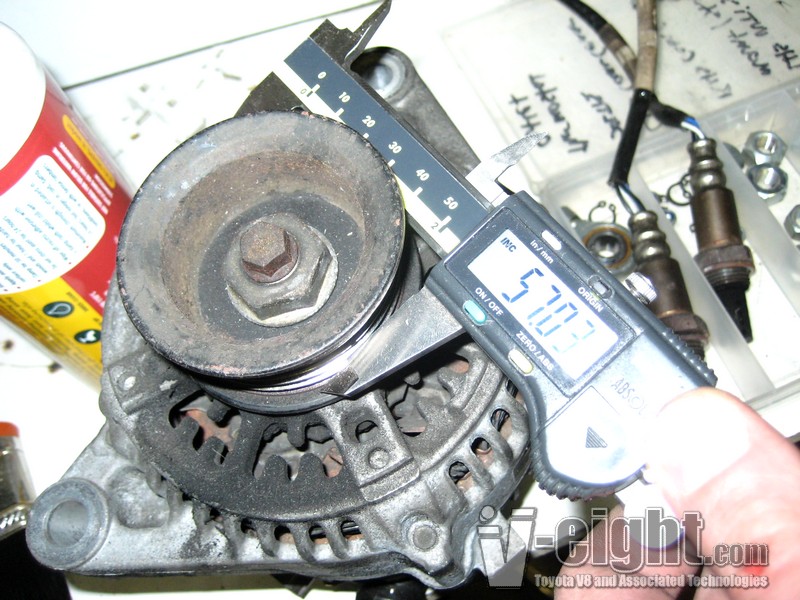

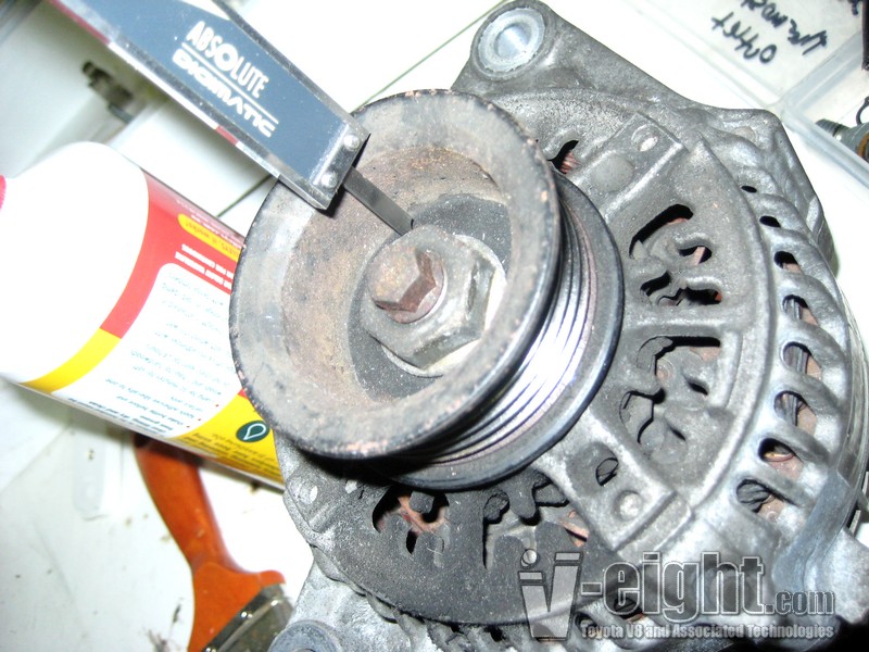

    the one that ive got is 57mm to peak of grooves, 53 or 54mm to the depth of the groove
    depth from the face of the pulley to the face of the mounting flange is 22mm
    pics to follow
