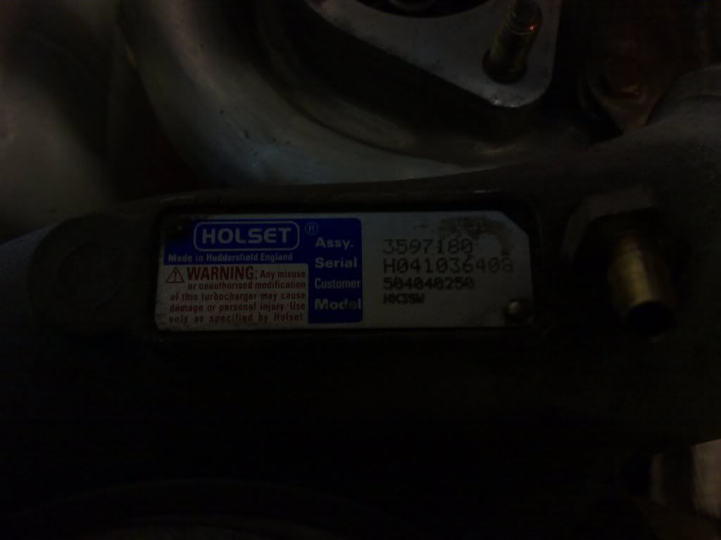

    Ok heres the assy, serial, customer, model numbers off the HX35W i've got.
    Assy - 3597180
    Serial - H041036408
    Customer - 504040250
    Model - HX35W
    I've been trying to find some more info on it but can.
    e30-323ti are these the number which will tell me the ex.h and compressor size ?

    According to HERE it is from a Iveco.
    Which then goes to HERE and only seems to be in spanish.
    Item 5: Ex Hsg 3532299
    Item 6: Turbing Wheel/shaft 3595832
    Item 7: Comp. Wheel 3599649
    Just need to cross ref. those part numbers to find the sizes I guess.
    The turbine hsg. size is cast into the hsg. just inside the inlet, will no doubt be soot'ed up so give it a clean.

    yeah thats all i could find on it as well, i'll give it a clean up when im next at the garage.
