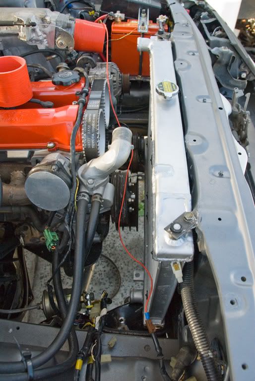

If it is like a 1GGTE, there are two plugs on the left side of the engine (looking from the front) up the top, underneath the distributor.
I am only using one of these sensors with my aftermarket ecu, I can't confirm whether both are water temp.

nothing around distributer.

So it doesn't have the plug you can see below the distributor in my pic? Hmm.
