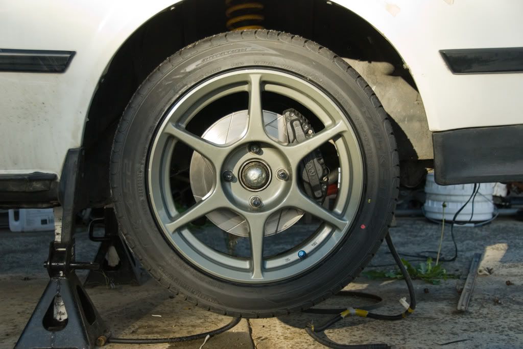

    If you don't want ricey, you can use satin VHT black. I'd say it was more matt than satin, that may be an application thing (front one that I did first came out textured; I'm usuall;y pretty good with cans).

    Quote Originally Posted by Stefan
    ummmm... Your rotors are backwards...
    p00 powar Grease Monkey Jin~Jah's Avatar
    148
    Default Re: Brake caliper paint
    Quote Originally Posted by Drifty Midship
    I second that motion
    816
    Quote Originally Posted by Jin~Jah
    Looks like left on the right, and right on the left, hay!
    Peter
    7,210
    depends on the manufacturer, some draw air in for cooling and some vent air out for degassing.
    148
    hmmm fair point... although wouldn't that be like having your directional tyres on the wrong sides, and then driving in the rain?
    silly gas pockets!
    TAS
    790
    OK, they are back to front (or at least are in these old photos, may jsut be the test fit). I didn't put them on though.
    Everyone notices the rotor slot direction, no-one notices the R32 front AND rear brake upgrade on an xA6x
    7,210
    I just thought it must have been a Nissan...
