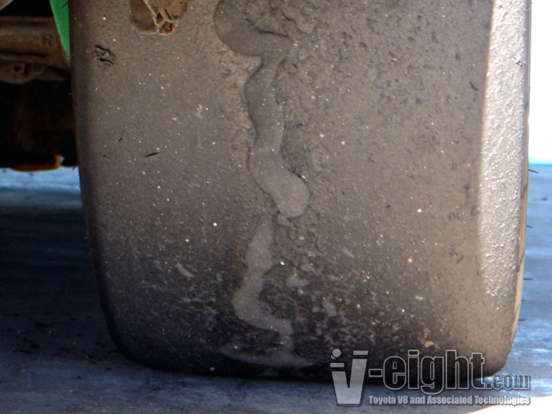

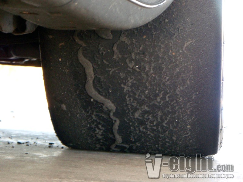

    ill thrown mine in for discussion whilst were at it...
    and fish - if youve got any material worth reading, please fire it my way too... [email protected]
    dunlops @ 28psi
    not sure what the temps were on this session, but previously, before getting them hotter (still learning the track) we were getting 60deg outside edge and 80deg inside edge
    subjectively, the car felt perfectly balanced, no front/rear bias towards under/oversteer, nothing. behaved very well infact. just need to go faster
    ed
    FRONT
    REAR

    Ed
    See the graining on the outside of the tyre?
    thats the stuff you want all over it.
    See the blue sheen coming through the tyre thats all its grippy goodness so to speak.
