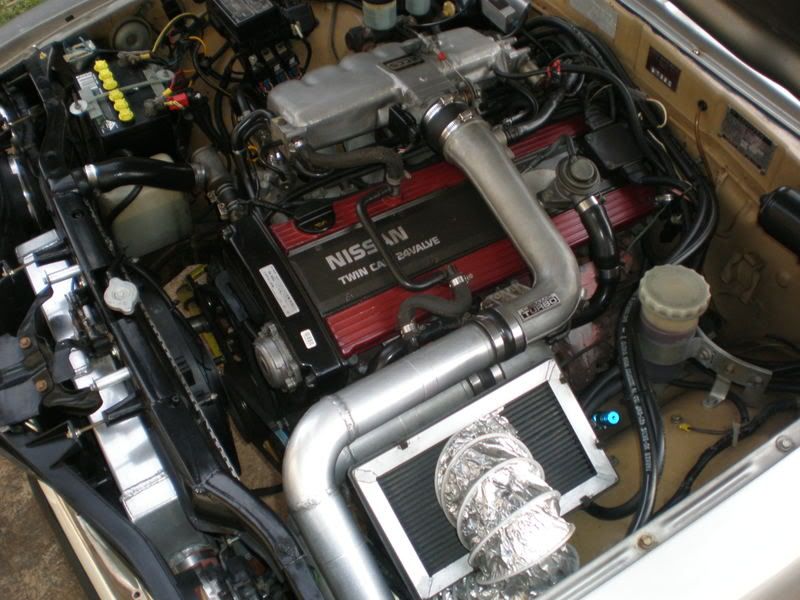

    Ok here's a couple of pics. It says ECCS on the injection. The guy did mention that the injection came off a later model.

    Speaking to the ex owner's father this morning, he recollects that the turbo is from an RB25 and has been highflowed. He reckons the tranny has been modified heavily but can't remember what size converter. The injection is from a later model as well, he said the head and bottom end are stock and that it's the same type that was used at Bathurst years ago.

    ahhh all is not lost!! you should be able to get some reasonable power from that then. how much boost is it running?
    if the turbo still has the orig ceramic turbine then about 12lb is the max RELIABLE boost you could run. the ceramic wheel's tend to delaminate at 14-15lb.
    probably best to get it on a dyno and see exactly what is holding it back, because it seems to have all the basic mods atm to net around 150+rwkw.
    you really should go manual is you want to get the most out of it. an RB20 gbox is only about 4-500.

    Apparently the ex-owner took it out to WSID and ran a 13.1 on 18lb boost.
    I'm trying to track down the original engine builder to get more info but can't find him yet.

    18lb would suggest that it has a steel-wheeled turbo then. motor seems to be the goods then, stock bottom end in an RB20 can take alot of punishment.
    13 is pretty quick though for an RB20, perhaps the converter is whats holding it back. i'd be trying to find out more info about the gbox build, because the motor seems to be up to scratch if it's running that quick.

    1J it, then u know what mods have been done, just get a 2800rpm stallie from MV and it will probably decimate the RB, then u can get on the 1J list
