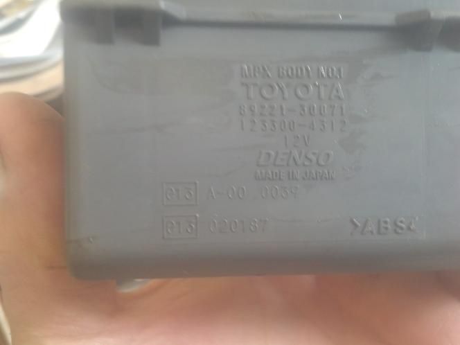

    I installed a JZS161 motor and auto into my Hilux and connected the Power/Snow switch to the number1 body mpx part number 89221-30071 . I know it worked because I also wired in the instruments. I later removed the auto and installed a manual . No need for this function any more so removed the MPX ecu. Here are pictures of said ecu. Note the wires I used for 12v and earth it may help .For wiring diagram see page 66 of Wilbo's pdf
