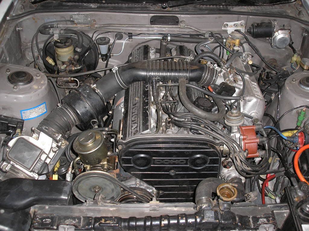

    Default 5MGE Rebuild Finishing touches, Sexy cam covers
    OK one final pic for the project...
    The cam covers fellas.
    Happy now
    -A

    Ah shit it looks like a nissan motor now LOL
    Dave

    Actually the first thought that came to my mind was ferrari, looks tight
