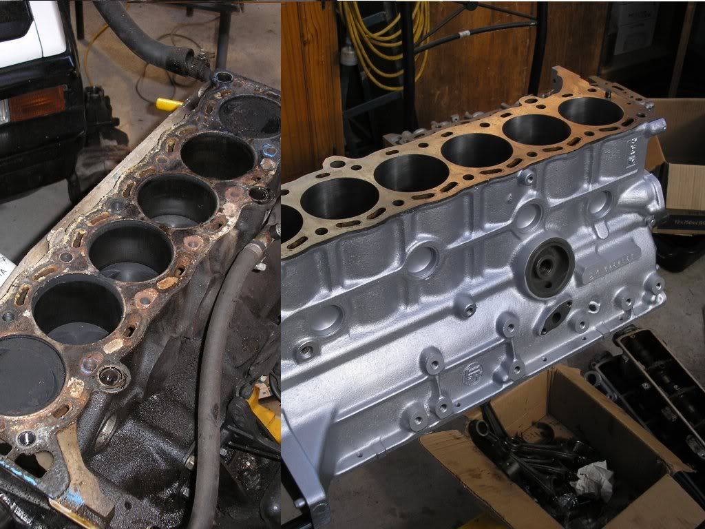

    Quick update,
    Just picked up all my goodies from the engine shop.
    Heads pressure tested ok, all nice and cleaned up.
    Block / Head had a few thou taken off, look almost new now
    Crank ground & pollished.
    Should have the bottom end back together this weekend,
    I still need to do some port work on the head & intake runners.
    Also picked up a set of new injector seals from united injection.
    Will take pix tomorrow, as I am stuck on late shift tonight :|
    -A

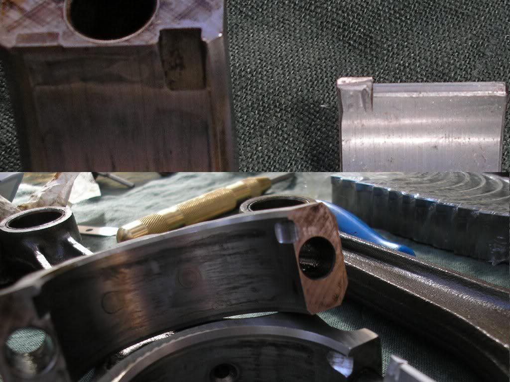

  8. #53
    Jun 2008
    252
    Default Re: 5MGE Rebuild. Parts Come Together... sort of
    Righty.
    Got some-what busy on the weekend with assembly,
    The head cleaned up very nice (despite corrosion in galleries).
    Block came up very nice too, gave it an aluminium upgrade….
    However on assembly of the bearings I encountered a couple of problems.
    #1 One of the main bearings is oversize (width) by about 2.8mm & the tang location is reversed.
    May be for an older model M engine, which had a larger centre main.
    #2 All the big end bearing had mismatched tangs
    Solution.
    Grind out new tang locators & Re drill new oil holes in offending parts.
    I can’t see this being a problem, tangs now match up correctly.
    Bottom end assembled, everything looks & feels sweet.
    Will start on the port matching / cleaning during the week.
    -A
  9. #54
    2,505
    Default Re: 5MGE Rebuild Begins... Cams anyone ?
    Good progress mate, coming along well
  10. #55
    2,183
    Nice looking head and block! Combustion chambers look like new. Really digging the alloy paint on the block.
  11. #56
    vic
    1,196
    The wide main bearing goes at the front , all from 8/1984 had this .
    Dave

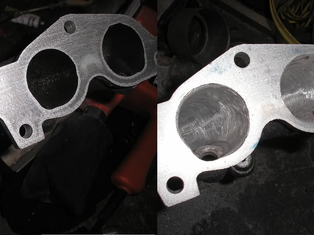

  12. #57
    Jun 2008
    252
    Default Re: 5MGE Rebuild Begins... Ports !
    Morning,
    Another quick update,
    Started work on the inlet runners yesterday.
    Came out like so:
    Removed about 1mm of material, to match inlet ports.
    Still need a final clean up.
    -A

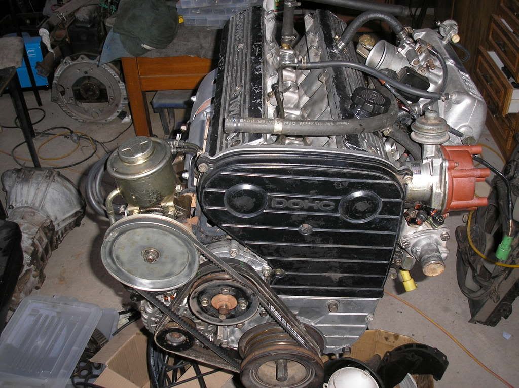

  13. #58
    Jun 2008
    252
    Smile Re: 5MGE Rebuild Begins... Cams anyone ?
    Ok
    Been a busy few weeks, bit it’s finally all together, Whoo!

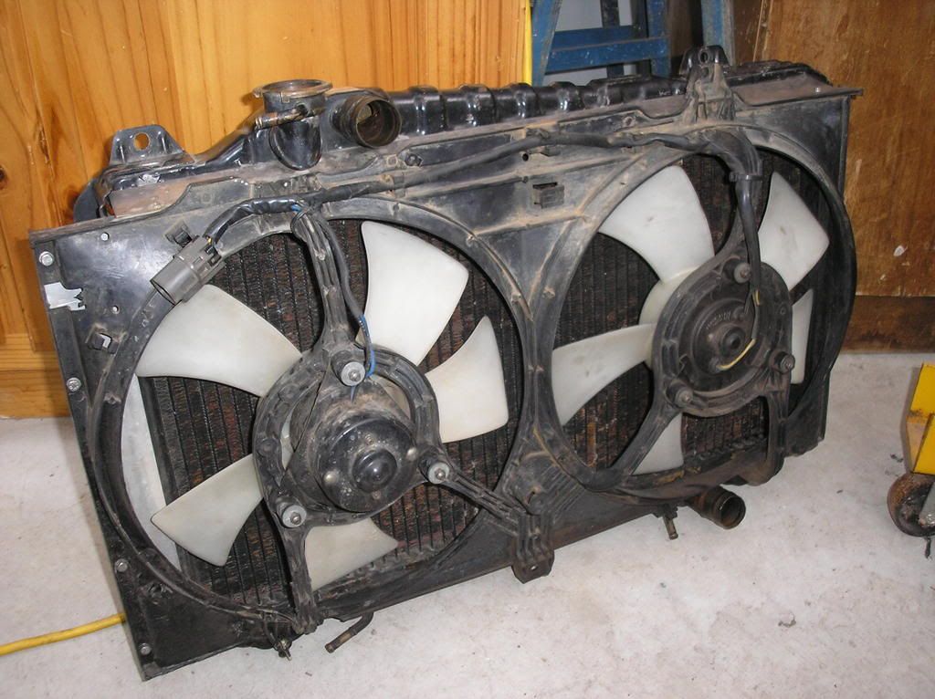

    While the engine was out I also fixed up a few other bits n pieces, including
    upgrading alternator, replaced power steering pump bearing & seal.
    Replaced gearbox rear seal, still need to get hold of a new W?? series lower shifter boot.
    Any one know where to buy them / have one laying around?
    Have also made a few changes to the wiring & thermo fans, (fans are from an old pulsar).
    Should be back in the car by this evening if all goes well.
    -A
  14. #59
    3,224
    Dude !
    How can you not have repainted the rocker covers ??? Nice work otherwsie
    1971 2T-B Celica TA22 ST.
    1975 2T-G Celica TA27 GT
    1985 3F Auto FJ62 Landcruiser
  15. #60
    307
    ^^ Agreed ^^
    an nice electric blue or red with polished raised sections would look perfect.
    Great to see someone having a go with a 5MGE. A great looking engine that has always lived in the shadows.
    jordan
