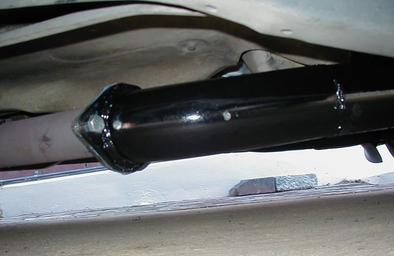

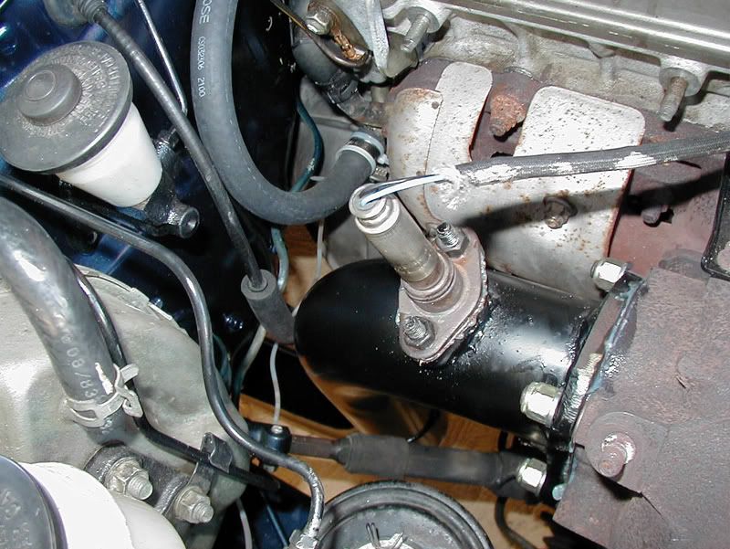

    Here's some pictures of my exhaust.
    Just a 3inch dump from the turbo back to under the car to mate upto my existing 2 1/4 exhaust ending with my Remus muffler. The quality is okay, not that happy with it but meh its an exhaust. Becuase the flange cutter broke down and he had to get someone else to do it, it looks like the flange was cut out in a real rush and looks quite crap actually. But ah well, it does the job.
    I've since hacked up the stock heat sheild and given it a coat of chrome spray paint and put that back on over the turbo which covers up the flange which is good. Looks tops.
