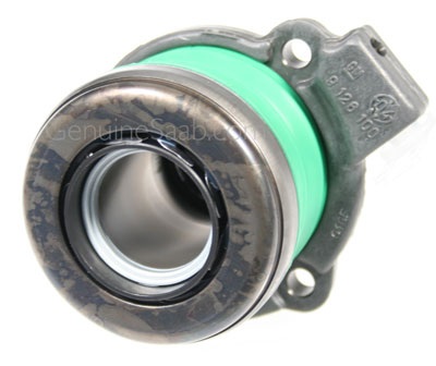

    Tilton throwout isnt that much, i have heard $100 bandied around.
    Hmm I seem to remember a figure of around twice that.. (around $190).

    tilton throwout is around the $400 mark new from memory and the price varies depending on if you want a cast or billet version.

    If you dont want to use a Tilton one, then use a Saab 9000 one, they are $98ea trade price from Adelaide Clutch (as much as i can dislike them)
    Lower stack height than the Tilton too, a few of the Formula cars over here use them.
