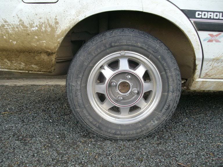

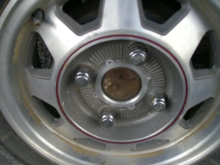

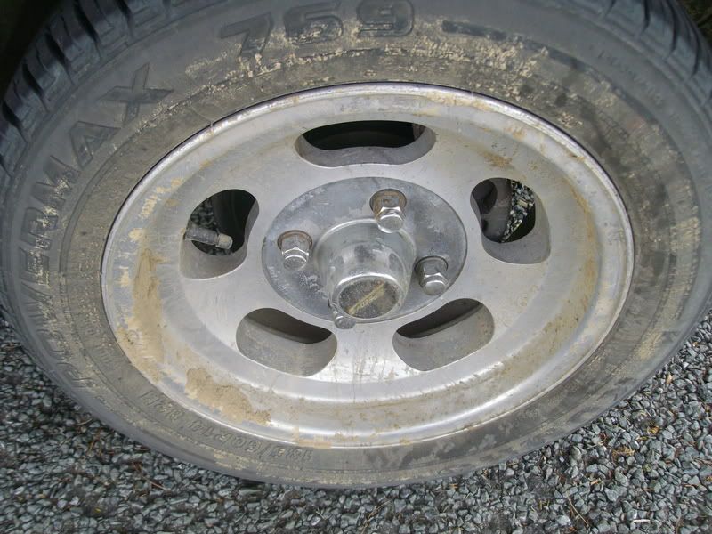

    Pictures.
    This is what was on the rear.
