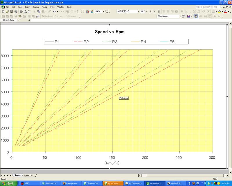

    A C52 with 4.06 gives me bang on 3000rpm.
    A chart I made up
