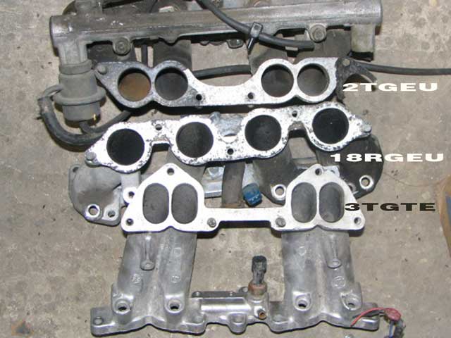

    Default Re: 18R-GEU intake manifold onto 2T-G
    unfortunately i don't have a comparison pic online... but this is the difference in the partition
    2t and 2tg ports are in similar places but bolt pattern different
    i have a few 2tgeu efi manifs too.. but again, postage will be a killer
    actually 2T and 2TG ports are in the same place, just the bolts are in different patterns
    u can weld ears onto the 2TG EFI inlet manifold to make it fit the 2T
