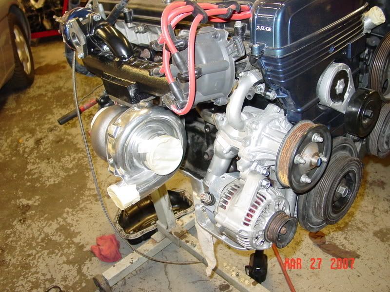

    reminded me of this 2JZ-GE Manifold.
    was wondering about the oil drain.
    Forum Sponsor Conversion King
    Dec 2006
    2,583
    Default Re: Interesting turbo manifold for 2JZ...yes its ebay
    oil drain would be a pinch of piss but the compressor outlet and piping may take abit of work.
    just do a Y pipe if you want to go the tightass route, cheap and reliable and probly no cruder than whats there.
