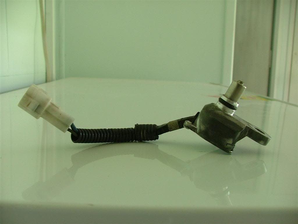

    121
    Default Re: 1GGZE into RT132 help needed
    [IMG][/IMG]
    Here is my SP2.
    It has 3 Wires
    Part No is 89544-30010.
    I assume that i'm having trouble because the Cruise Control had something to do with this.
    I'm not using the cruise control, so maybe i need a different Speed Sensor.
    Is there one that simply sends a signal directly back to SP2 Pin in ECU??
    I am not getting any signal at SP2 Pin at ECU.
    I have checked the solenoids with 12v connected individually, and they are working.(Click)
    Help Please!!
    Glen.
