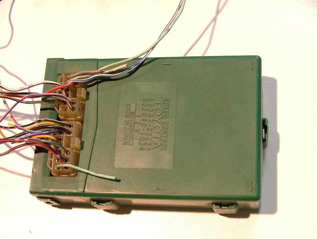

    I think i've found it...i had discarded it thinking it was only to do with the Cruise Control !!
    It's a Green Plastic box with 2 plugs (about 20 wires) and looks like a computer inside.
    Tried to post a photo but couldn't get it to work. ( By the way...How do you get photos to come up directly in a post??)
    Anyway i am learning s l o w l y what all the bits are called!
    ( It does have Speed CONTROL written on it !)
    All the wires are cut, so it will take me a few days to sort out as much as i can...then i'll be back calling for help again.

    speed control would normally mean its the cruise ecu but without seeing it im not 100% sure.
    GA61XX, can you post a pic of the ETC as ive never bothered paying much attention to them but need to get one as im sick of driving the auto thru the gears with the shifter.

    This is what i thought might be the ECT ??? Can't find anything else.
    Oh, and the shift lever was missing from the cut so i am in the dark with the O/D Switch.
    [IMG][/IMG]

    Can anyone tell me whether the box in the pic above marked 'Speed Control' is just for the cruise control operation or do i need it for the ECT?
    Also my 1ggze is a gen3 with grey plugs so I think the ECT stuff is built into the ECU.
    Can anyone confirm??

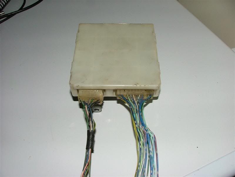

    Also what is this? It has no markings or part number, and seems to have too many wires for ECT.
    [IMG][/IMG]
    Thanks.
