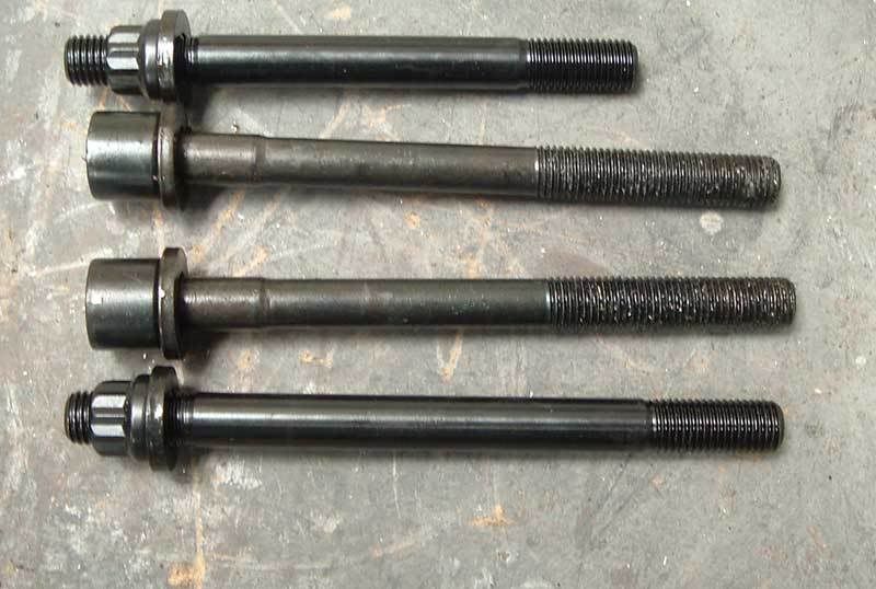

    The 20v bolts as they are fitted to my spare engine with the right washers
    20V bolts in the middle and the arp 16V studs on the outer

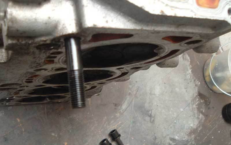

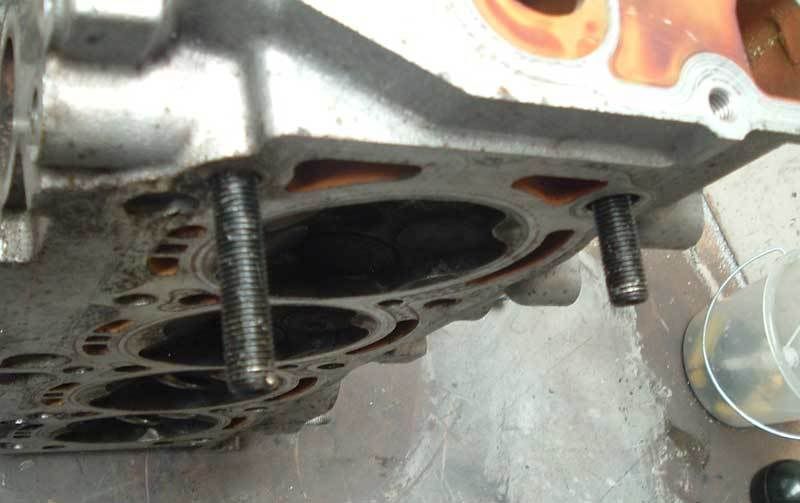

    Many have said that you need the two longer 16V studs on the 20V, well this picture shows the longer stud installed in the low side of the 20v head, as you can see I have no idea what they are talking about

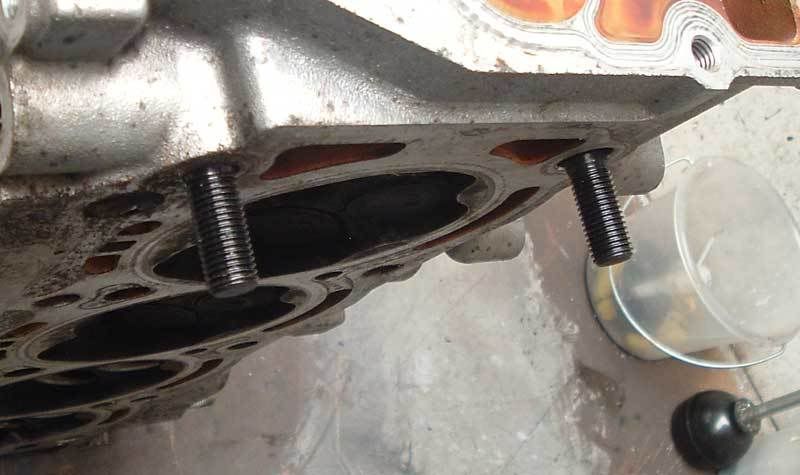

    Here is the 16V studs installed exactly the same way as what you would for a 16V, at first they seem too short but looking closely you will see that thats the start of the thread near the face of the head so no more thread can be put into the block. While the 20v bolts on the exhuats side normally thread further into the block this is the same block as the 16V and it uses the same amount of thread as the 16V head. So in conclusion I see no reason why the 20V head should be any different.

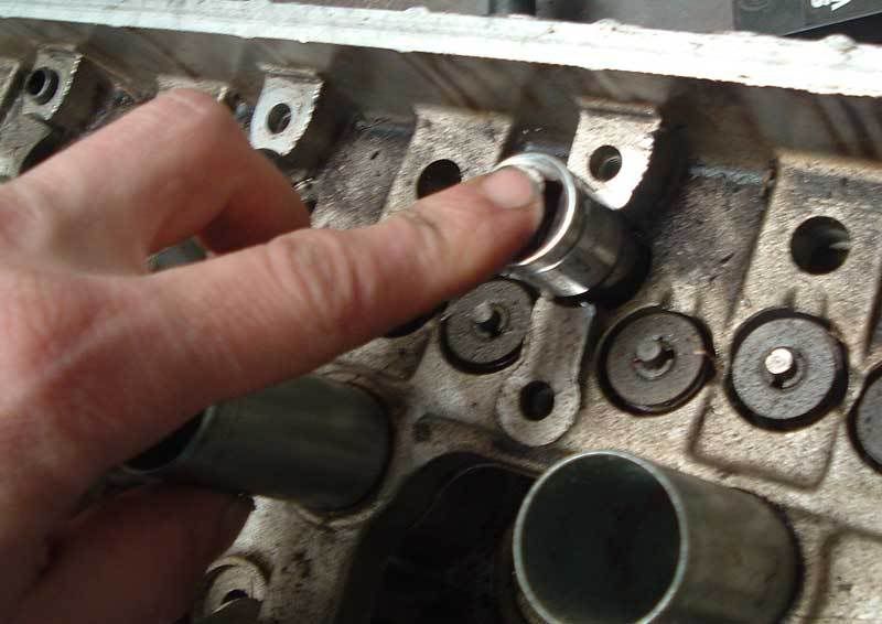

    This is the top on the high side, as some have sujested there might be clearence issues luckily its very far from the case. Pictured is a 1/2 inch drive 12mm socket on the head of the ARP nut and even with such a bulky socket it doesnt touch.
    The low side is the same story, clears with ease and that with a socket much larger than what you would normally use I would think.
    Final verdict = 20V is the same as 16V in studs
    I am happy to make inidvidual measurements of stud shank and thread lengths for anyone who wants to know.
