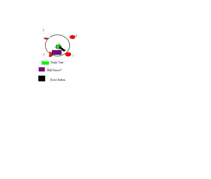

    thanks chuck I did what you said set crank in between the timing marks 12-5deg , so roughly 10 deg. Then with the rotor, positioned it on the contact of # number1 . With the hall sensor, is it like the contact point on mech dizzy? if so this is how it set it up
    When cranking it feels like it wants to go, but as soon as I let the key go she dies
    could there be a fuel issue now? I'm totally stumped
    ps could i have stuffed up the cam timing?

    Do the numbers in the diagram correspond to the cylinders that the leads go to???
    If so they are in the wrong order.
    The firing order is 1-3-4-2
    if not - When cranking the engine(with the distributor cap off) watch the direction the rotor turns and then set the leads in the 1-3-4-2 order from the # 1 lead that you have set already.

    Still sounds like you have ignition only on crank, and not on ignition from the ignition switch. And yeah like sleektoy said with the firing order.
    Might be worth rechecking the cam timing.
    If you have been rotating the engine without the cam sprocket pin in place, you will have bent valves. I fail to see how the pin/dowel could have come out, unless the guy who built the engine had NFI.
