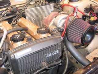

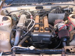

    This is mine.......

    Either way you do it, if you are going to mount it far out from the head like the one in the picture you'll definitely want to go about adding some bracing to it to stop it cracking.

    well this was a very first turbo manifold i had and still using it today.
    except the turbo is a little bigger now.
    hehe the blue covers didnt last too long...
