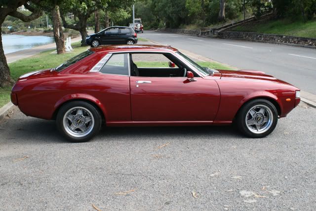

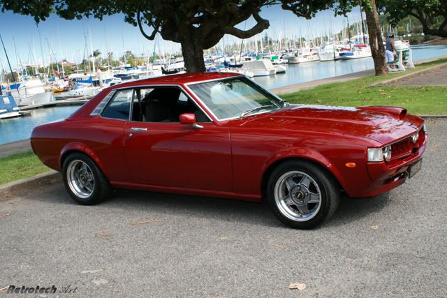

    I've been mucking around the last couple of weeks with the ride height. Even though I said I'd never cut springs, I've done so to get my ride height worked out. By cutting one coil off the pedders (red ones) I've ended up roughly where I want to be. The kings went lower than the original pedders but not quite this low. The Kings are for sale on Ebay now. Now I've just got to decide if I will go coil-overs or get shorter shocks. If I do get shorter shocks, can anyone else confirm that the SW20 rears will fit into my RA23 standard struts?
    -Paul.
    "If you keep fixing it for long enough, eventually it WILL break."
    - RA28 3TGTE - I sold it. Bad idea. www.glisten.net.au/celica/index.htm
    - RA23 3TGTE - 168rwkw 12.9sec Toffee Apple [URL="http://www.toymods.org.au/forums/threads/26625-RA23-3TGTE-168rwkw-12-9sec-Toffee-Apple?p=561925#post561925[/URL]
  9. #39
    stunt dog Backyard Mechanic Esteban's Avatar
    wa
    444
    Default Re: Options for lowering RA23/RA28
    Well it certainly looks good ... :-)
