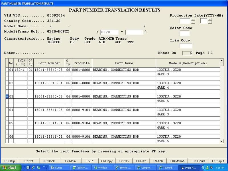

    2,765
    Default Re: Bottem end bearings for 1GGTE
    i would assume yours will be the later one 8808-9104
    and im not sure what the 03, 04 or 05 part of the number is. maybe standard then oversize?
    toyota should be able to tell you.
    ring castle hill and tell them your a toymods member
    cheers, andrew
    3/4/5 im sure are the oversizes. My rods had a 3 stamped on the side of them and they were standard sized to suit the 42mm crank.

    dont give them the p/n
    let them work it out for themselves and you just check that you both come up with the same thing. they have alot more experience than me. and have been trained in using the system. that said, they do still cock up. hence i have my own EPC
    cheers, andrew
