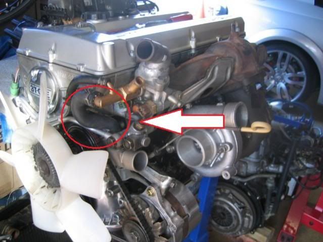

    I know I posted this before, but I'm urgently in need of the coolant bypass hose. They are discontinued from Toyota and I can't find them anywhere.
    Does anyone have a used one in usable condition or know where to get a new one from?
    Here's a pic:
    Also looking for the throttle cable brace that bolts to the top of the intake manifold if anyone has one? Thinking I'll have to make my own but though I'd ask anyway!
    Al

    Quote Originally Posted by toyo-al View Post
    Al
    I have no factory hoses on my cars these days due to modifications etc...
    I simply draw a diagram with measurements plus inside/outside diameter and head down to Repco or supercheap and look through their hose collection. I have yet to fail in finding a hose with the right basic shape to cut down etc.
    Jason

    toyo-al: you can get a straight hose os same ID and witha heat gun or hair dryer, slowly heat the hose and bend it to desired shape and once it cools it should hold relatively well. As for the cable bracket, i am in the same boat so if you make something please let me know.
