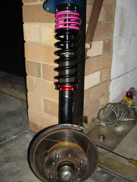

    Have you tried Noltec?
    Thats where I bought mine from. About 2-3 years ago though, so dont ask me what the price was. (bought these pink helper springs and the ring that seats between them and the main spring.) If you get some more I might be in for a set for the other car.
    PS, I had no choice in the colour LOL
