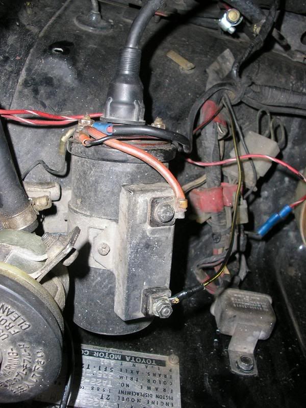

    I tested a few things out with the help of ian. with the ignition on, i took the centre dizzy lead which was running from the coil off and touched it against some good metal, but no spark. Put a cable from the +ve terminal from the battery onto the negative part of the coil, tried to start it but no success. There is power running to the positive side of the resistor when turned to ignition. About to try opening and closing the points manually to see if it makes a spark.
    Any other ideas as to what else i should test?
    Coil and resistore is looking like this atm:
    Should there be any leads running from the negative side of the coil besides the one from my dead switch (red a white wire)?
    Thanks for the help, Joey
    on the -ve of the coil should be dizzy wire (connects to mech points/radio supressor cap) and tacho wire.
    have your car on reds, and open the points with a flat head screw driver, see if there is a spark and if the points are pitted/corroded.

    Grrrr thats very annoying since there aint any wiring coming out of the dizzy besides what looks like a grounding which follows into a major piece of the wiring harness and is followed through the front of the engine bay. Nor is there any tacho wire to speak of which may explain why my tacho has never worked correctly in the first place Any idea of the colour wire it should be?

    Just had a quick look through one the haynes manual and what i thought liked like an grounding wire is indeed the dizzy wire which is going through the front of the car somewhere for god knows what reason. Also checked the points, no spark, they look a little bit corroded but shouldnt be enough to cause it not to create spark.

    Ok problem fixed Although its not exactly back to the way it used to be im happy that it runs. The kill switch was at its tricks again and for some reason was giving the dizzy no power, so i cut out the kill switch wire and added a new wire which goes from the negative side of the coil onto the previous connection which runs into a loom. Now to dismantle the kill switch and see ehat was messing up!
