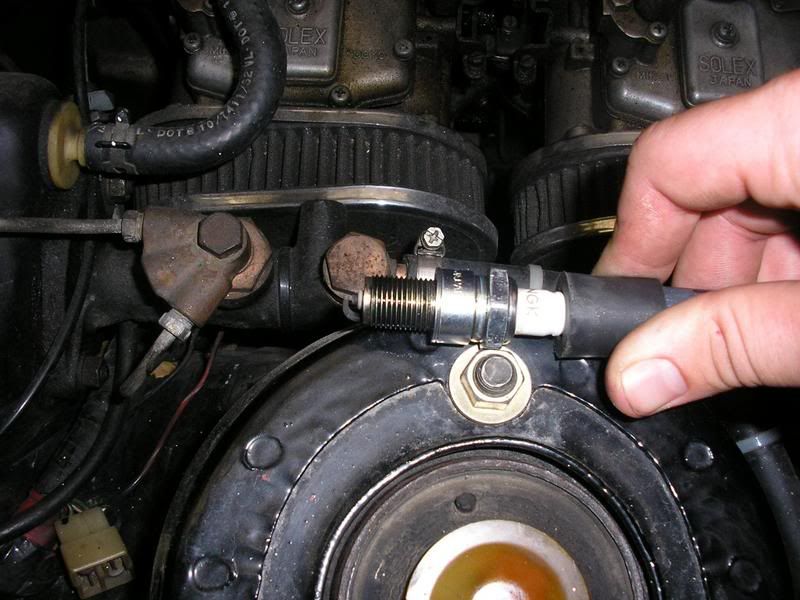

    Sorry for teh noobness but how can i check if its getting spark? probe one of the spark plug wires whilst cranking the engine over? (Just want to try and figure this one out on my own instead of taking the easy way out and calling the racv )

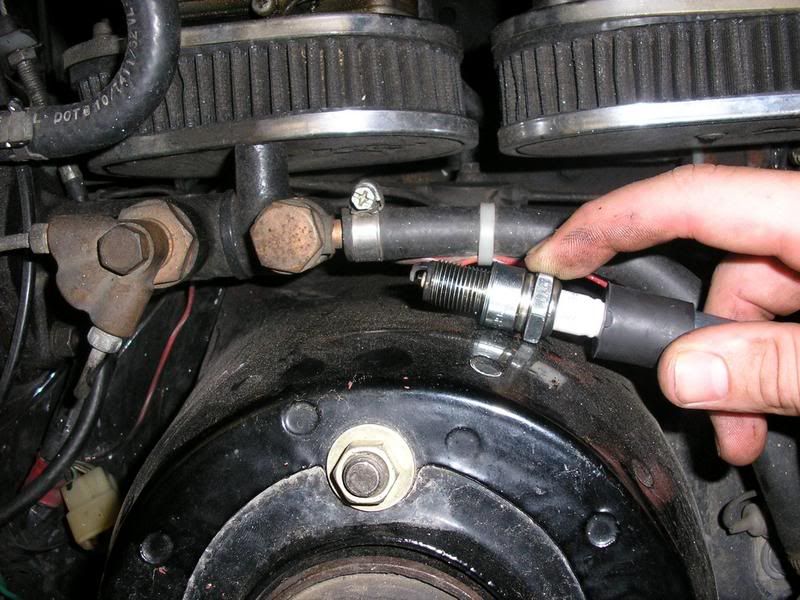

    2) To check spark, you make sure that there is spark at a spark plug. To do this you:
    a) remove a plug from the head
    b) connect the lead back up to the plug
    c) remove all other leads from their plug so it doesn't start on 3 cyls
    d) hold the metal of the plug so its firm against the metal of the engine
    e) have someone briefly crank the car.
    f) I repeat, make sure you hold the plug FIRMLY against the steel part of the engine. The 30,000 volts generated by the coil creates a spark between the electrode and the grounding at the engine. If they are not touching, the ground is made through YOU. You learn that quickly enough

    Thanks for all the help guys. Tested for the spark and i could see nothing. I followed timbos steps and all is good except instead of earthing to the motor i earthed to the body work because the was no room anywhere on the motor that was metal :s. This should have been a sufficient earth, correct?:

    Hey Joey with the spark plug if you can rest it ontop of the strut tower near the strut bolt say 1/2 to 1cm away that way you have a clean contact with the chassi , where you have it in the photo the plug is not grounded due to the paintwork . If its dark the spark will be easy to see if not get someone to crank her while you watch the spark plug. just make sure you're not in direct contact with the plug and lead... otherwise you'll get a nice suprise
    Hey Joey,
    Don't be lazy, there'll be some engine metal somewhere
    But if you do go to the body, just make sure it is on a CLEAN earth like neverland suggested, ie: no paint or rust. Maybe give the strut tower nut a rub with a wire brush, then use that.
