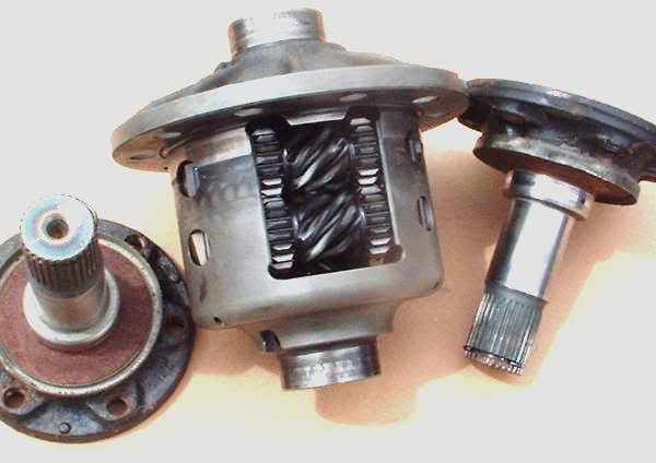

    Here is a pic of a g series torsen and an a series which fits JZA80 Supra JZZ and UZZ Soarer and Aristo can you spot the difference

    Got any other pics? Possibly one without the bearings attached?

    Here is one with axles but no bearings

    heres a G series in all its glory:
    http://www.supraforums.com.au/forum/...ad.php?t=15670
